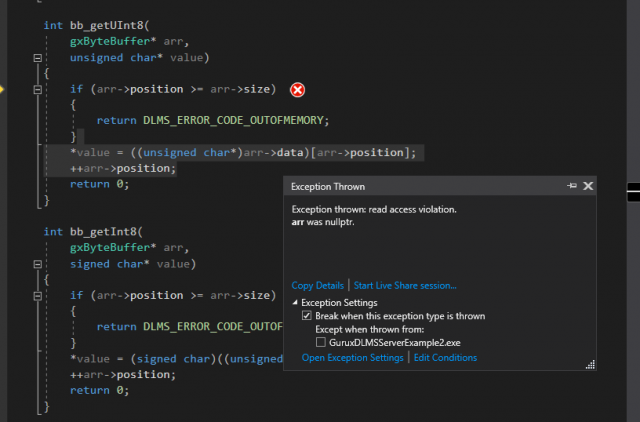

1 - We tested and tried to execute the script id 1 from the GXDLMSDirector, an exception was thrown (check the picture). So we followed the code: in the gxinvoke.c file in invoke_ScriptTable() -> if (sa->type == DLMS_SCRIPT_ACTION_TYPE_WRITE) -> cosem_setValue() -> cosem_setRegisterActivation() in the gxsetignoremalloc.c file -> else if (index == 4) -> cosem_getOctetString() -> bb_getUInt8() is throwing an exception "read access violation arr was nullptr". This is the first issue to solve.

THESE INFORMATION ARE LINKED TO THE POST #1
Let me add some information concerning the issue number #1 in the post #1:
- When we try to write directly the active mask of the register activation from the GXDLMSDirector everything is going right without any exception: cosem_setRegisterActivation() -> index = 4 -> cosem_getOctetString(value->byteArr, &object->activeMask) or the value->byteArr is filled with the new active mask correctly
- Back to our issue, when we try to write the active mask by triggering the execute method of the tariffication script as "DLMS_SCRIPT_ACTION_TYPE_WRITE" it is throwing an exception because the value->byteArr is empty and is not filled with any relevant data. So you should fill it with the new active mask before triggering cosem_getOctetString().
