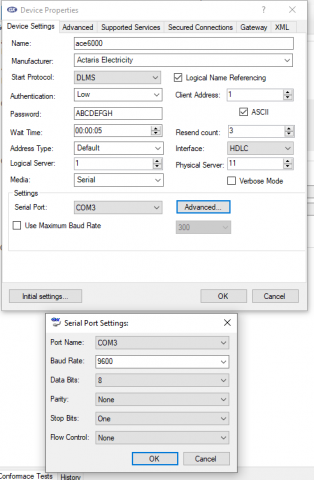

Hello. My name is Evgen. I can't connect in Gurux GXDLMSDirector to ACE6000 via RS485 (after press "Connect" get "Fail to receiver reply from the device in given time"). For serial port i have 9600 8n1. I try with Authentication None and Low (with password ABCDEFGH) and get same connection error. In serial mort monitoring program i saw that data sent to ace6000 but nothing received from ace6000. Anybody can help me to solve this problem?

i tried 2400, 4800, 9600 and 19200 baud-rate. I tried to connect to both of 2 ports RS485 (on this meter 2 ports). This meter have DLMS label. I two times make connection cable (from RJ45 contact 4,5 to RS485 contact A , and from RJ45 contact 2,7 to PS485 contact B). What else can I try?

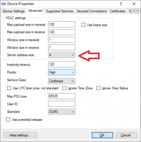

Your settings are correct, but I just remember that there are ACE6000 meters that require that server address size is 4 bytes. Try this: Change "Server address size" to 4 like picture below.
