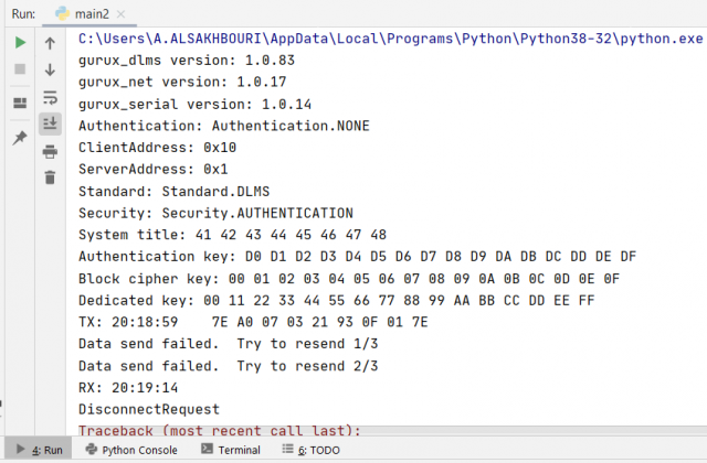

I use optical port probe to communicate with the meter. I installed Gurux.DLMS.Python package with all requirements.
meter company | SAGECOM
I executed the following command
command:
python main.py -S COM22:9600:8None1 -t Verbose -d DLMS -C Authentication -A D0D1D2D3D4D5D6D7D8D9DADBDCDDDEDF -B 000102030405060708090A0B0C0D0E0F -D 00112233445566778899AABBCCDDEEFF
But the meter is not responding,
The output is shown in the image below.
Any help?
6 years ago
One of the settings is wrong. Can you connect without ciphering first?
I believe you should try with GXDLMSDirector first. I also believe that your client system title is wrong.

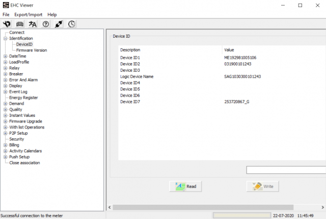

I already tried with GXDLMSDirector without ciphering but no response received (also I tested with ciphering) . It shows this message "Failed to receive reply from the device in given time".
I already tested the meter with the company software and it works successfully.

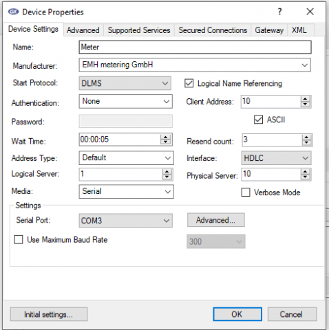

I solve it by changing the
I solve it by changing the client and server addressing.
6 years ago
If you share the client and server address we can add a device template so it's easier to use from GXDLMSDirector.
HERO
6 years ago
This is the meter settings.
Client Address = 0x10
Physical Server = 0x10
Logical Server = 0x1
In Gurux.DLMS.Python , what will be the value of server address as decimal value?
6 years ago
The manufacturer settings file for Sagemcom Energy & Telecom is added.
The server address is -s 144.

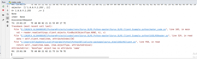

I tried to read logical object 1.0.0.9.2.255 from the meter through gurux.DLMS.Python, but it displayed an error I think it means that no logical name found for this. But this logical name is correct.
How can I read these logical objects?
6 years ago
There are no objects with the logical name "1.0.0.9.2.255". Check the logical name.
