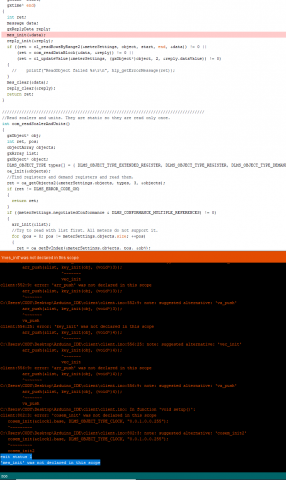

I"ve tryed to compily with SERVER.INO it was succesed, but the CLIENT.INO is not compilating...:
Related problems
(exit status 1
'mes_init' was not declared in this scope) this is pasted part of an error from ARDUINO.IDE
How can I fix a problem? If you have advice or decision of this problem... you're welcome.

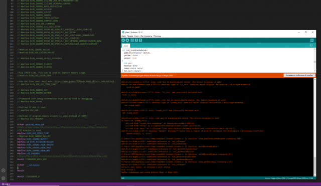

I did everything according to
I did everything according to your instructions, but I didn't get rid of the error. Tell me please, where have I made a mistake? and thanks for the quick reply

Don't update images. They are compressed and others can't read them.
Un-comment this:
#define DLMS_IGNORE_MALLOC
