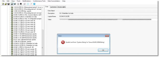

I am trying to change the ESWF(Event Status Word Filter) which has got Bit-String Data Type, but getting error(attached image) even when i change any bit in edit window and write write operation seems deactivated even when meter has provided read-write access to respective attribute.
Please suggest where we could be wrong.
Thanks in Advance

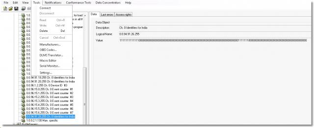

Second Image
Second Image

Hi Deepak,
Hi Deepak,
Please, don't post images. They are compressed and in your PC they look OK, but others can't read them.
Can you read value and then write it back and post trace here?
Post only those 2 commands.
