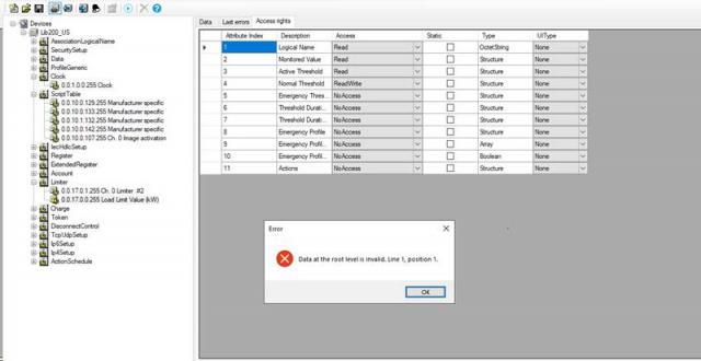

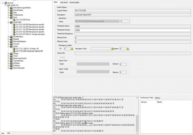

I could not able to write an attribute of Limiter Class which was even given read-write access, please have a look at the attached images.
Please suggest where we could be wrong.

You don't have access rights to the attributes. You can't modify them for this reason.
