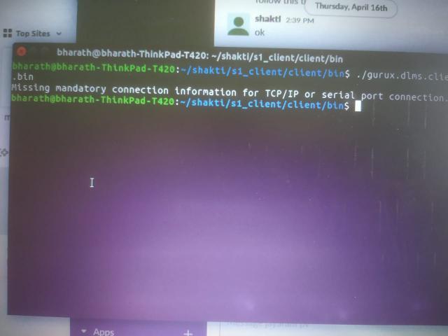

Hi Sir,
Hi Sir,
How I am using that command??. Because for Client already make file given and when i am compile client it generate " gurux.dlms.client.bin" .
Shakti
shakti0031
6 years 3 months ago
Hi Sir,
Hi Sir,
Whenever I compile dlms client is showing ( Attached photo ).
Shakti
Run your app like this:
gurux.dlmsclient.example -h YOUR_SERVER_IP_ADDRESS -p YOUR_SERVER_PORT_NUMBER"
