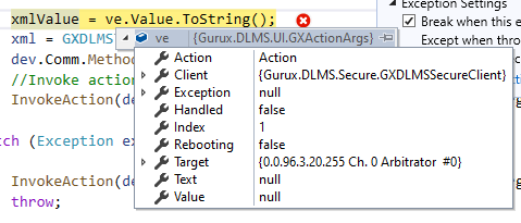

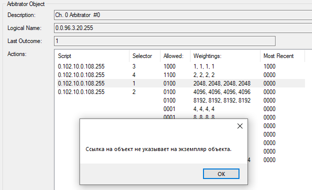

But when I try to send "Request Action" an error occurs.
6 years 1 month ago
Can you say what this is in English? For me, it seems that the script is selected only for the first four items and I believe this is causing the problem.
MNN
6 years 1 month ago
System.NullReferenceException
System.NullReferenceException.
The Value is always null when selecting any script.
And if "Reset" click the same error occurs.

Thank you for pointing this out. The reason for this is that the invoke parameter is null when it should be 0. This is fixed and new version is released.

And Arbitrator has attrubute
And Arbitrator has attrubute 6 - last_outcome (unsigned), can you add it?
6 years 1 month ago
I'm sorry. This was my mistake. I need some time to think of how this is implemented on the UI. New version is released on next week where this is fixed.
I just check and Last outcome is there. It's above Actions, on the left side.
