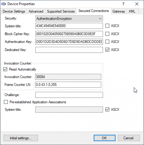

GXDLMSDirector reads the invocation counter automatically from the meter. You need to read the data object where the invocation counter is saved and update it to the client.
We'll update example clients for this. In the meantime, you need to do it by yourself.
Check GXDLMSCommunication.cs and find:
//Read frame counter if GeneralProtection is used.
That does what you need.

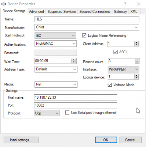

pramodahanya
6 years 6 months ago
Adding the security
Adding the security parameters as i could upload only one image.
