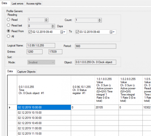

lrd2
6 years 7 months ago
1. Yes, the firmware version is the latest.
2. There is data in the specified period - please see attached screen below. I can read profile entries by Gurux Director, you can see non-null entry for 2019-12-02 10:00.
That's what makes me think that the problem might concern gurux java implementation, not the gurux or meter itself, as it works in director.

So I should obtain the same
So I should obtain the same format as I get in GXDLMSDirector, which according to you is:
07 E3 0C 03 02 00 00 00 FF FF C4 00
These are my datetimes when particular skips are set:
Nothing skipped: 07 E3 0C 02 01 00 00 00 00 FF C4 00
Miliseconds and day of week: 07 E3 0C 02 FF 00 00 00 FF FF C4 00
Day of week only: 07 E3 0C 02 FF 00 00 00 00 FF C4 00
Miliseconds only: 07 E3 0C 02 01 00 00 00 FF FF C4 00
So the closest to GXDLMSDirector is skipping only miliseconds:
07 E3 0C 02 01 00 00 00 FF FF C4 00 //milliseconds skipped
07 E3 0C 03 02 00 00 00 FF FF C4 00 // GXDLMSDirector
I marked the difference (02 01 vs 03 02). What more should I change?
02 01 Is the day of month and weekday. I'll check this.
Can you send a log to me by email from this?
