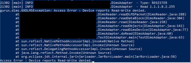

I'm trying to read data from a DLMS device using your sample code and i get the error that appears in the attached image.
Could someone give me a clue on how to solve this problem?

Please, don't post images. It's hard to get an idea what is happening.
The reason for this usually is that your access level is too low or you try to write wring value type.
