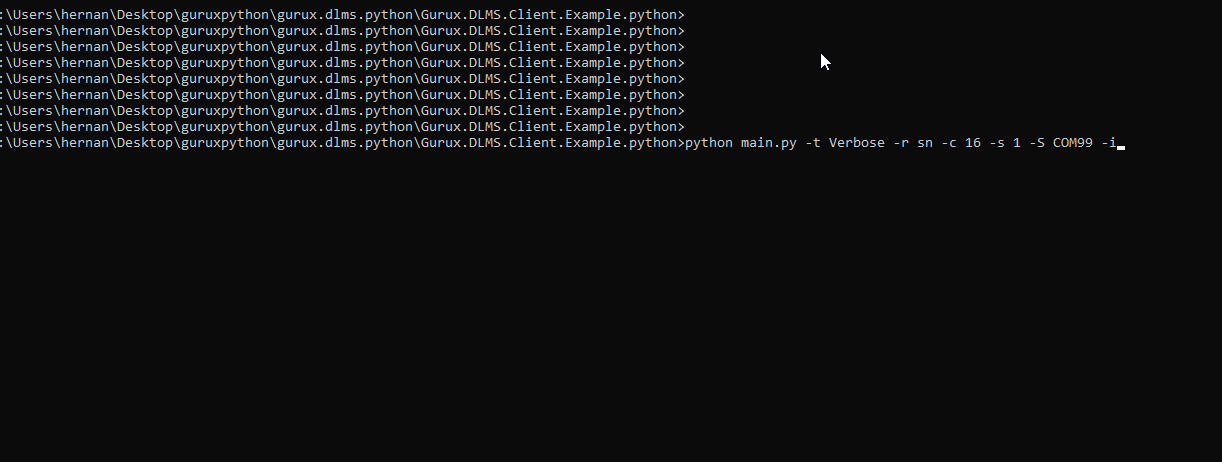

With Java older versions I
With Java older versions I get connected at least, and I can read some codes, the biggest problem I've got with new versions (Java, also python version!) is that it reads no answer, even though the meter do answer..
I've recorded the behavior for you to see, with a byte counter (attached gif)
hernan
7 years 1 month ago
To see animated
To see animated
https://media.giphy.com/media/UqFpBwgrlnnirPgG4Y/giphy.gif

PD: About python version, it it only gives this answer (note 15 seconds between send and reply, even though meter responds immediately)
Gurux.DLMS.Client.Example.python>python main.py -t Verbose -r sn -c 16 -s 1 -S COM99
ClientAddress: 0x10
TX: 15:28:08 7E A0 07 03 21 93 0F 01 7E
RX: 15:28:23 7E A0 1E 21 03 73 C3 7A 81 80 12 05 01 80 06 01 3E 07 04 00 00 00 01 08 04 00 00 00 01 07 22 7E
7 years 1 month ago
We'll check python. You need to decrease the wait time. The message is lost and I believe it's causing the problem. Change wait time example to 10 seconds and try again.
