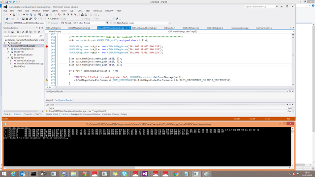

Kindly refer the below mentioned code. After My sample application is not true for first condition and true for second condition. Is it means my meter does not support "readList" method?
Kindly find the attached file of my program and its output. The method "readList" has failed and showing "Invalid Parameters" error.
Kindly suggest me asap.

You are right on this. If DLMS_CONFORMANCE_MULTIPLE_REFERENCES bit is not set meter don't support readlist and all the values must read one by one.
