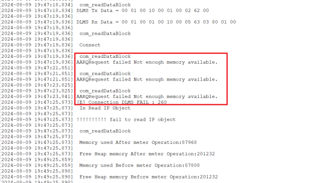

We are currently using the Gurux.DLMS (C Language) library for meter testing. After configuring the DLMS client and attempting to read from the meter, we are encountering a "not enough memory" issue.
I've attached a screenshot for your reference. Could you please review it and provide your suggestions on how to resolve this issue?

The meter is returning invalid data. Please, don't add screenshots. They don't tell anything. Plain text is better.
If you add send and reply messages as a hex string, I can check what is wrong.

com_readDataBlock
Connect
com_readDataBlock
AARQRequest failed Not enough memory available.
com_readDataBlock
com_readDataBlock
