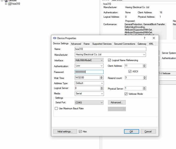

Hi, in Association view on…
Hi, in Association view on the gurux director soft everything I added manually and work fine (read only).
I want to read all the alerts and some of them to reset them .
when I make hardware installation of the meter the tamper alert goes ''active''.
To make proper installation of the cables we must remove the plastic cover of the electric contacts and when I did that the "tamper" alert is active.
How can I reset that with the Gurux software??

Hi, If you need to reset…
If you need to reset values you must change the authentication level. You need to change the client address and password also. The correct values should be on the documents.

As I told you I know the…
As I told you I know the password!!!
is : 0000000000000000
when I try to add that pass (change the settings to High level security on Director settings ) the program stacks and stop responding .

Hi, Now you need to know the…
Now you need to know the client's address. The client address is different than the meter expects and the frame is ignored. GXDLMSDirector try to establish the connection, but the meter doesn't reply. You can try to solve the client address with HDLC address resolver. You can try with client address other than 0x10. That is for public authentication.

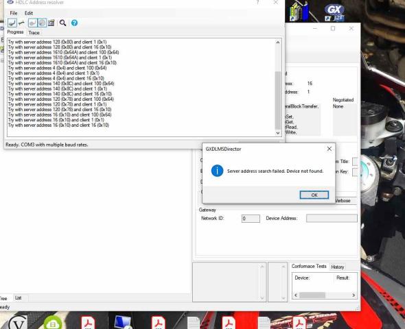

Hi Mr. Mikko, I have try…
Hi Mr. Mikko, I have try many server address 'numbers'
1
16
4
128
192
32
146
140
120
148
96
but I receive the same error .
can you guess or have any idea what is the correct server address for my meter??

Hi, I believe that your…
I believe that your server address is 1 because you can connect without authentication.
The client address is the problem. You must use the correct client address or the meter doesn't reply. The meter manufacturer selects the client address and it can be anything from 1 to 127.

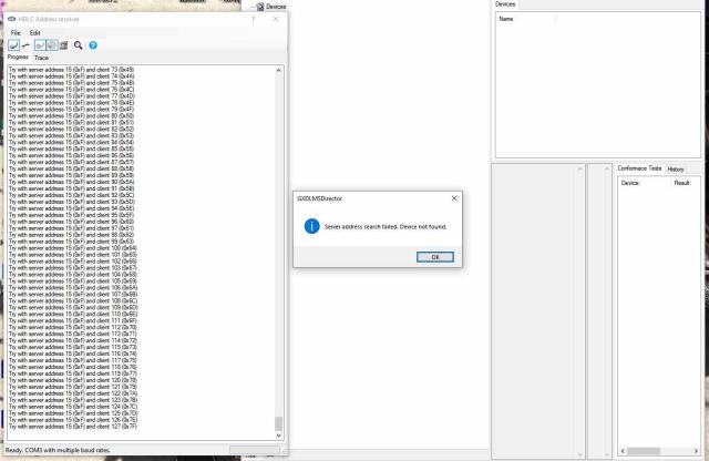

HI, I have try all the…
HI, I have try all the combinations for
client address and server address for:

identical error to all my attempts . What am doing wrong??
do you have experience on issue like that??

After many attempts to connect with low security I receive that communication from the meter, it stack again .This is my settings Client address 11 physical server 1 logical server o
17:01:10 05:01:10.933 Info Opening

Hi, I have try many many…
Hi, I have try many many combinations of client and server addresses. The same result , the program stack again and again!!! The logical server is set '0' is there a chance to be wrong that setting???
Do you know any (or some trick) other way to find the HDLC address?????
