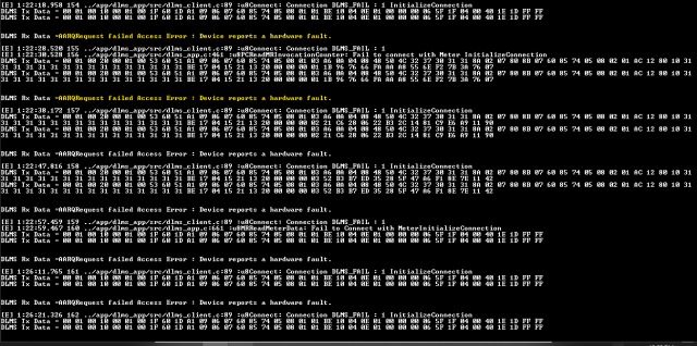

I am using Gurux DLMS library for ANSI C to communicate with meter.
Facing the error as "AARQRequest failed Access Error: Device reports a hardware fault" when try to communicate with meter.
In which case device reports a hardware fault?

Hi, Please, don't add…
Please, don't add pictures. They are impossible to read.
Can you add a hex log as plain text so I can check this?
