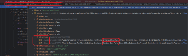

Yes, I certainly tried with the serial android example app. When connecting the device, 2 ports with the same name are available: CP210x UART Bridge.
When selecting ANY of the ports, sending is ALWAYS carried out via the Enhanced COM PORT, which in USB is with the index 0. This is hardcoded in the line: UsbInterface usbIf = it.getValue().getInterface(0); (GXSerial.java, line 768).
When changing the code, the Standard COM PORT interface would be used: UsbInterface usbIf = it.getValue().getInterface(1); the serial android example app also has the error "Data send failed."

Вот изображение, которое…
Here is an image that shows that the null interface is always selected, regardless of the selected port.
