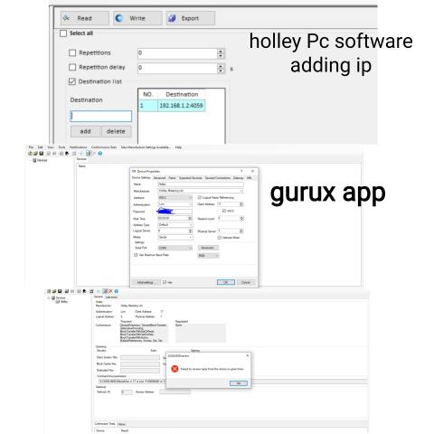

I am reaching out for guidance regarding my recent endeavor to establish communication with a DLMS smart meter using Holley meters. As someone new to this domain, I am currently navigating the initial setup phase and encountering some difficulties.
Primarily, I am uncertain about the appropriate starting point and procedure for establishing communication with the meter to retrieve data. Despite my efforts, I have been unable to establish a connection successfully. Currently, I have configured an IP address for the meter utilizing the Holley meter software provided. However, upon attempting to retrieve data using Gurux software, I encountered an error, as illustrated in the attached screenshot.
I have also experimented with connecting via COM port, but unfortunately, encountered the same issue (i.e., "no reply from the meter within the given time").

Hi, One of the settings is…
One of the settings is different than the meter expects. I can't remember if Holley is supporting WRAPPER with TCP/IP connection.
If you can get the hex log e.g. WireShark I can get the correct settings for you. Just the first row is enough.

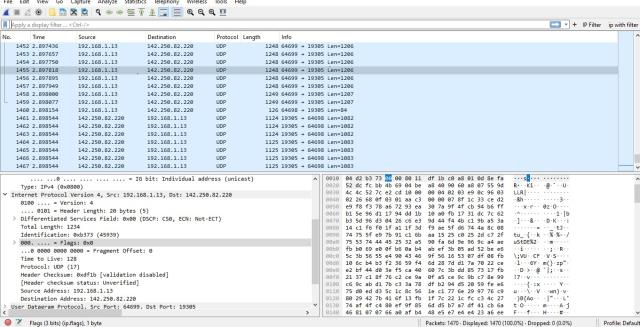

Hi I have Checked on the…
Hi I have Checked on the Wirshark using the Wifi and here is the attached image and Hex logs for the reference.
Please correct me if i provide you wrong information.

Hi, I'm afraid that the data…
I'm afraid that the data you gave is incorrect. The destination IP address should be 192.168.1.2 and the protocol is TCP/IP.

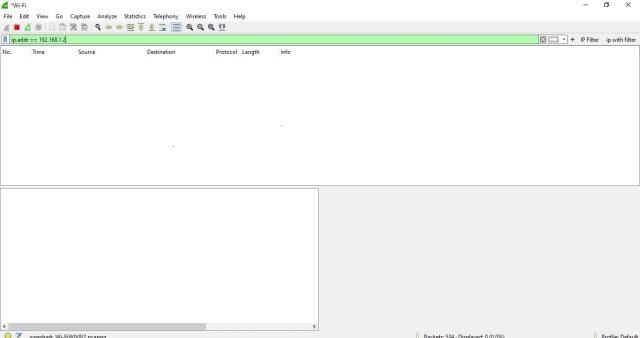

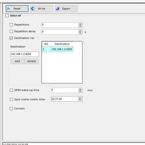

I have updated the IP that…
I have updated the IP that is 192.168.1.2 and that IP is not conflicting with any device But when i go to wireshark and filter same IP i am getting nothing.

Hi, The two common errors: 1…
1. Did you select the correct interface in Wireshark? This is a common mistake if you have multiple NICs.
2. Did you try to read the meter after you started the Wireshark?
Try also with this filter:
tcp.port == 4059

We are able to connect the…
We are able to connect the meter using PC software in two ways
- Using com Port
- ⁠Wireless connection:
these are the three option when we have to add in the PCsoftware to connect Wirelessly
- Server IP ( provide by them)
- ⁠Global device id
- ⁠Port
but when we assign our local or server ip to the meter it is not working but when we add the server IP provided by them then meter connect perfectly so what can be the issue ? if it can be the authentication issue then what it can be ?
