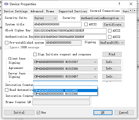

I can use the ECDSA suite1 and One-Pass Diffie-Hellman connect to the meter. But when I read the data from the objects,it shows "Object reference not set to an instance of the object. "
And I try to change the key agreement from one-pass to none,then I can read the data successfully. So Why does this error occur?
The log is below:

Hi, I need to check this. I…
I need to check this. I don't know any meter that uses One-Pass Diffie-Hellman and has not been used for a long time. All the ECDSA meters are using GeneralSigning.

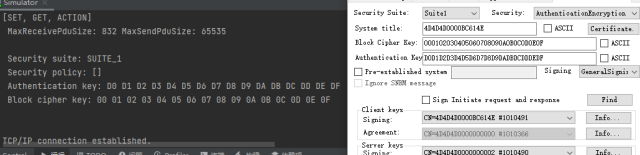

If I use GeneralSigning. It…
If I use GeneralSigning. It shows the error "Decrypt failed. invalid authentication tag." So how to solve this problem?
The server log is below:

Hi, I use the simulator…
I use the simulator meter and it supports ECDSA.When I set the key agreement "None",director can read the data. But when I use GeneralSigning. It shows the error "Decrypt failed. invalid authentication tag."

Yes,I use the Java version.I…
Yes,I use the Java version.I check that the client and meter are using the same key.But the problem still exists. Will it be related to the certificate or private key?

the server log is below:…

Hi, I believe that the…
I believe that the private key is not yet used. Do you have a meter that you can read to get the correct ECDSA settings?
ECDSA is very complicated and if one of your settings is not what is expected the connection is not working.

Hi, Unfortunately, I don't…
Unfortunately, I don't have a real device. Could you give me an example of the correct ECDSA settings ? Using suite1 and general signing.
If possible, I would greatly appreciate it
