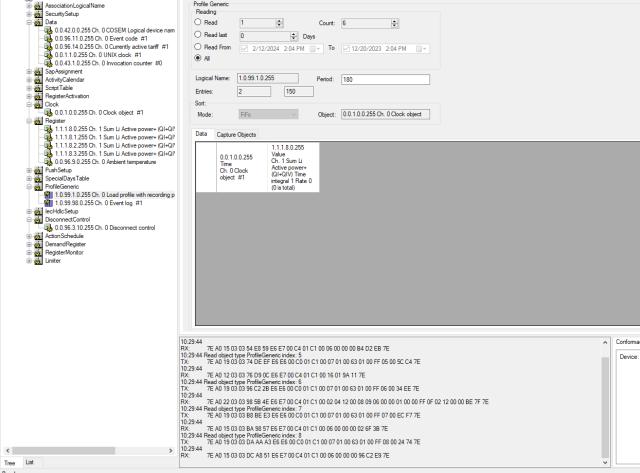

i could not see in the data tab even receive it as in log. here is my log:
10:29:44 Read object type ProfileGeneric index: 4
TX: 7E A0 19 03 03 52 EA AB E6 E6 00 C0 01 C1 00 07 01 00 63 01 00 FF 04 00 84 DD 7E
10:29:44
RX: 7E A0 15 03 03 54 E8 59 E6 E7 00 C4 01 C1 00 06 00 00 00 B4 D2 EB 7E
10:29:44 Read object type ProfileGeneric index: 5
TX: 7E A0 19 03 03 74 DE EF E6 E6 00 C0 01 C1 00 07 01 00 63 01 00 FF 05 00 5C C4 7E
10:29:44
RX: 7E A0 12 03 03 76 D9 0C E6 E7 00 C4 01 C1 00 16 01 9A 11 7E
10:29:44 Read object type ProfileGeneric index: 6
TX: 7E A0 19 03 03 96 C2 2B E6 E6 00 C0 01 C1 00 07 01 00 63 01 00 FF 06 00 34 EE 7E
10:29:44
RX: 7E A0 22 03 03 98 5B 4E E6 E7 00 C4 01 C1 00 02 04 12 00 08 09 06 00 00 01 00 00 FF 0F 02 12 00 00 BE 7F 7E
10:29:44 Read object type ProfileGeneric index: 7
TX: 7E A0 19 03 03 B8 BE E3 E6 E6 00 C0 01 C1 00 07 01 00 63 01 00 FF 07 00 EC F7 7E
10:29:44
RX: 7E A0 15 03 03 BA 98 57 E6 E7 00 C4 01 C1 00 06 00 00 00 02 6F 3B 7E
10:29:44 Read object type ProfileGeneric index: 8
TX: 7E A0 19 03 03 DA AA A3 E6 E6 00 C0 01 C1 00 07 01 00 63 01 00 FF 08 00 24 74 7E
10:29:44
RX: 7E A0 15 03 03 DC A8 51 E6 E7 00 C4 01 C1 00 06 00 00 00 96 C2 E9 7E
10:31:34 Send Keep Alive
TX: 7E A0 19 03 03 FC 9E E7 E6 E6 00 C0 01 C1 00 0F 00 00 28 00 00 FF 01 00 F9 79 7E
10:31:39 Data send failed. Try to resend 1/3
10:31:44 Data send failed. Try to resend 2/3
10:31:49 Failed to receive reply from the device in given time.
10:31:49 Disconnect request
TX: 7E A0 07 03 03 53 80 D7 7E
10:31:49
RX: 7E A0 07 03 03 1F E8 5F 7E

it seems to be reading a lot…
it seems to be reading a lot of rows. restart DLMSDirector and reset load profile. then it perform normaly
2 years 9 months ago
Hi, You have read your…
You have read your values and then there is a delay. The meter closes the connection after the inactivity timeout has elapsed.
Check your inactivity time from the HDLC Setup object and decrease it from the GXDLMSDirector "Advanced" tab.
https://www.gurux.fi/Gurux.DLMS.Objects.GXDLMSHdlcSetup
