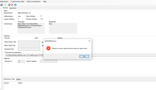

Hi my friend, I have an electric meter landisgyr E570 serie2 firmware V84.10.12 and I use GURUX DLMS DIRECCTOR to read data with optical probe
but when I try to connect with optical probe it says "device not reply"
can you please reply to me I really need your help thanks
2 years 6 months ago
Hi, One of your settings is…
One of your settings is invalid. First select Landis+Gyr as a manufacturer, now you have selected Elster. Try to connect first without authentication (None).
Then try to change the Interface type from HDLC to HdlcWithModeE.
