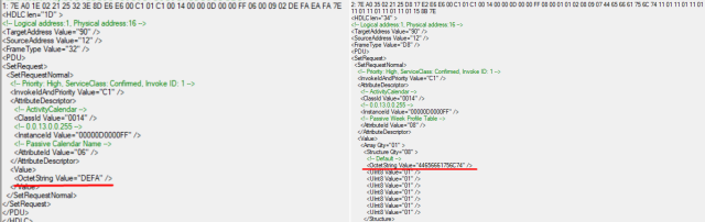

Hello!
When I change Passive Calendar Name to "Default" I get an Error from the meter.
I noticed that in TX from DLMSDirector name is passed directly without encoding it to Octet String.
08:29:36 Writing object 0.0.13.0.0.255, interface ActivityCalendar
TX: 7E A0 1E 02 21 25 32 3E 8D E6 E6 00 C1 01 C1 00 14 00 00 0D 00 00 FF 06 00 09 02 DE FA EA FA 7E
When I do the same for Week Profile it works fine and week name is encoded
08:32:32 Writing object 0.0.13.0.0.255, interface ActivityCalendar
TX: 7E A0 35 02 21 25 D8 17 E2 E6 E6 00 C1 01 C1 00 14 00 00 0D 00 00 FF 08 00 01 01 02 08 09 07 44 65 66 61 75 6C 74 11 01 11 01 11 01 11 01 11 01 11 01 11 01 15 8B 7E
DLMSDirector version is 9.0.2311.1001. Is it intended?

Below are screenshots where…
Below are screenshots where I highlighted parts that don't match.
In case of Week name Default is passed as a <OctetString Value="44656661756C74" />, while Season name as <OctetString Value="DEFA" />

Hi, We have tried to repeat…
We have tried to repeat this and it works every time.
I noticed from your last pic that you are comparing two different write.
On the left side, you had written the passive calendar name and on the right side, you had written the week table.
Can you try to set the passive calendar name as the picture below and try to write it?

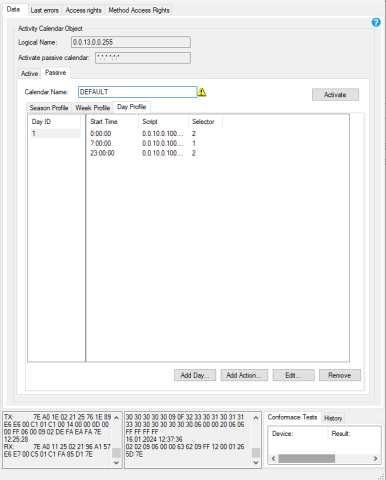

Hi. I compared to different…
Hi. I compared to different write because a can write Default as a Week Name and can't as a Calendar Name. I think that there should be no difference between them, that's why I am confuesd.
Result of trying to write DEFAULT as a passive calendar name
TX: 7E A0 1E 02 21 25 76 1E 89 E6 E6 00 C1 01 C1 00 14 00 00 0D 00 00 FF 06 00 09 02 DE FA EA FA 7E
RX: 7E A0 11 25 02 21 96 A1 57 E6 E7 00 C5 01 C1 FA 85 D1 7E
2 years 10 months ago

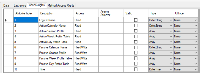

Hi, Can you select "Access…
Can you select "Access rights" and take a screenshot from that page?
This is now tested with a few meters and it works without problems.
SmileLime
Here you are
Here you are
