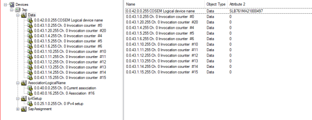

I have a Actaris SL7000(SL761W071 2021) meter and I want to read values from OBIS like active energy... etc
I am able to connect with DLMSDirecto but I cant get that data from all OBIS, I only get this:
https://www.gurux.fi/sites/default/files/styles/thumbnail/public/forum/…
Could anyone help me?

I was investigated and I found that exist diferents profile where I can get the data, but theses profile have a password. Have anyone the default pass of these profile?

Hi, Have you tried this?…
https://gurux.fi/GXDLMSDirectorExample
pedro jimenez
2 years 11 months ago
Yes, I tried that pass but I…
Yes, I tried that pass but I dont get the data. I am looking for Electrician and Engenneering passwords.
2 years 10 months ago
Hi, If you want to access…
If you want to access the association view data that needs a password you should ask it from the meter vendor. It's common that the default password is changed.
Can you connect with Low authentication using the default password?
