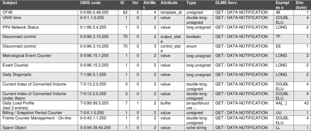

After researching for a few days, I've finally been able to decode CF48 & CF101 frames from a watermeter (manufactured by Sagemcom) using your Gurux.DLMS.Python.
I'm writing to you now because I need a little further help. I'm wondering if there's any way to get the values decoded from this decoded frames (see attached picture).
In instance, having the following decoded CF48 frame:
0001000100010088db08b44c5603004201077d3000000016e433ab3ab040a9d5f3b1392516c9d8a670036c3416177ccecb3e0c9e9caee1b0423f42a67190ebc85a82d92ff97163543173d9c6773a1246f230b40a6213f0679d5706fdf994e60cdaca200aa75cca8987933cf63f0fdc6d0d635b6c28efd9d37bffd186430786b2589313a49e44e62eb711fc208fad4f6c
¿Is there any way to get an output (JSON or XML format) from the different fields according to the below specification? ¿Is Gurux.DLMS.Python able to perform this?
I'm looking forward to develop a service that that could be able to get an output like below:

Gurux DLMS libraries are not able to parse the Trama compatta messages at the moment and you need to do it by yourself. All CF messages are coming in a byte array.
You can use DLMS client to parse received data notification message. Then you need to get the first byte from the data and check what CF message this is. Then you need to manually parse the messages.
Like this:
30 //CF type 48
6554DADE //Unix time
0003//PP4 Network status
01 //Disconnect control output status
01 //Disconnect control control status
000600100080000000D50000000003655015820080000000D500000000655167010080000000D5000000006552B8820080000000D50000000004000000001AA5F6FFAC1005146C3E00000A00290053002B00000100C0A10133"

Finally this is what I am doing, once I get the decrypted frame in XML format using the GXDLMSTranslator class and the messageToXml method, I proceed to parse de output XML (needed to clean it as output info are in comments section)get the value of the OctetString (where deciphered frame is located) and start parsing the byte array according to the specification I received for both CF48 & CF101 frame types.
Now I wonder, is there any way to get the OBIS codes from the data frame received? Can you show me/link any example where these are used in the python library? I'd like to know how to use/retrieve them.
Thank you very much in advance!
2 years 11 months ago
Hi, No, You can't get the…
No, You can't get the OBIS codes from the received frame. They are not saved to make the data size smaller. You need to check CT subject from the first byte and then parse the received data.
You can convert de-siphered data to XML using pduToXml-method.
0F000000000002010962306554DADE00030101000600100080000000D50000000003655015820080000000D500000000655167010080000000D5000000006552B8820080000000D50000000004000000001AA5F6FFAC1005146C3E00000A00290053002B00000100C0A10133
