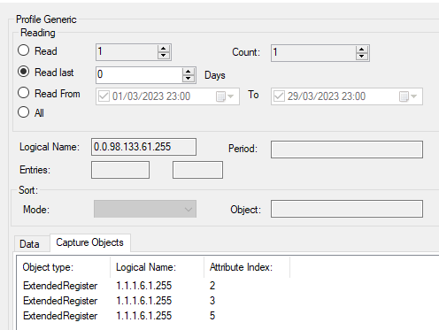

Hi, Kurumi.
Please, I have an issue whith ACE6000 meter.
Obis code missing(1.1.1.6.1.255 for exemple) in ExtendedRegister list, but exist in Profile generic.
Thank you in advance.

Hi, Part of the ACE6000 (and…
Part of the ACE6000 (and SL7000) objects can be accessed only with profile generic. You can't get the current values and you must read the profile generic and get the value from there.
I don't know why ACE6000 is implemented like this or what is the reason for this.
