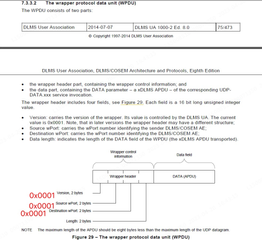

UPDATE: I have emailed them…
UPDATE: I have emailed them the list of commands GuruX doesn't support.
In the meantime all they sent me was the attached photo but it doesn't say much about the CLOU commands, just the WRAPPER format in general

Hi, It is always good if the…
It is always good if the meter manufacturer answers your questions. I know several manufacturers with poor support, even if you have a lots of meters.
This document from the WRAPPER doesn't help. I hope that they will add this PDU to DLMS standard.
