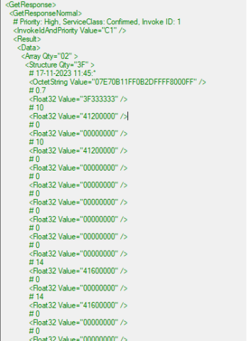

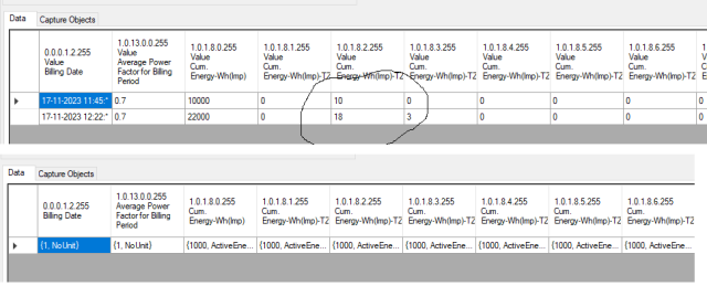

I am reading billing profile from meter and i see that scaler values in this case 1000 is applied only to cumulative energies but Tariff-wise energies are shown without scaler.
This report is causing interpretation issue. Attached is the reference pic for both bill profile and its scaler profile.
Request you to fix this issue.

Attached bill profile xml
2 years 8 months ago
Hi, GXDLMSDirector reads…
GXDLMSDirector reads scaler values from the register and the scaler profile is not supported at the moment.
