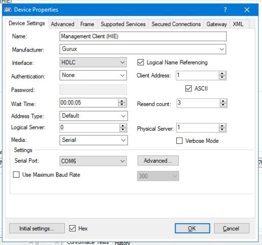

2 years 8 months ago
Hi, Your client address is…
Your client address is public access (0x10). Also, your authentication level is None.
This is public access, not the management client.

Ondrej_Pokorny
Hello Mikko, Management…
Hello Mikko,
Management Client address is 0x01, access is "AuthenticationAndEncryption".
I think that Director uses Public Client to get frame counter before communication with Management Client ( tab Properties-SecuredConnections-InvocationCounter-FrameCounterLN).
BR
Ondrej
Hi, You need to change the…
You need to change the authentication level. In your picture it's None and it's reserved for the public client.
GXDLMSDirector uses public client to read the invocation counter when needed and it's returned back after the read.
