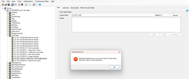

Script Table
0.0.10.0.1.255 MDI reset / End of Billing Period
Respective action schedule object is not showing , while reading the object it shows an error that specified argument was out of the range of valid values. Parameter name: invalid parameter

Hi, I tried to read Action…
I tried to read Action Schedule Object using the L&G E570 and it worked without problems. Can you open C:\Programdata\gurux\GXDLMSDirector\LastError.txt and add it here so I can check if that is helping?

LastError.txt from the…
LastError.txt from the mention folder
System.ArgumentOutOfRangeException: Specified argument was out of the range of valid values.
Parameter name: Invalid parameter.
at Gurux.DLMS.GXDLMSClient.ReadList(List`1 list)
at GXDLMSDirector.GXDLMSCommunicator.ReadList(List`1 list)
at GXDLMSDirector.MainForm.Read(Object sender, GXAsyncWork work, Object[] parameters)
2 years 10 months ago
Hi, In your trace below, you…
In your trace below, you are not reading values with ReadList. You are reading them one by one.
You can try to select "Supported Services" tab from the meter settings and then un-check "Multiple references". Try to connect again and read your meter.

Thank you very much of the…
Thank you very much of the support. it works well
