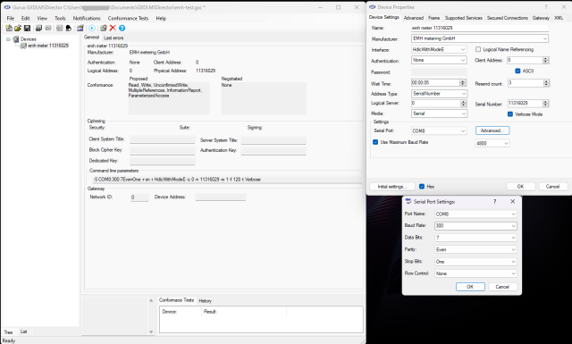

I am trying to read out en EMH Meter LZQJ-XC via an optical read head (OP-204).
From the manufacturer website the meter should be DLMS compatible https://emh-metering.com/en/products/special-meters/lzqj-xc/ .
So far I managed to get the HDLC handshake info in the logs but the SNRM request runs into a timeout.
The logs show that with the change to mode E yields a response but after reopening the Serial Port the SNRM requests don't get a response.
What I noticed is that the Serial Port is opened again with different Data Bits (8 instead of 7) Parity (none instead of even) compared to the initial serial settings.
I can read the meter (although via iec62056_21) with a different python script. In that one I keep the serial settings when switching interface speeds. However I am aware that DLMS is not the same as iec62056_21 so that is why I want to ask if the serial settings are expected to be always the same for it (8 data bits, no parity, one stop bit) or if this is why I don't get a response afterwards?
Here the logs (I also tried to limit the baud to 300 but no change):

Hi, The data bits and parity…
The data bits and parity are changed when moving from IEC to DLMS. The meter tells that the used baud rate is 4800 and for me it looks that IEC part is correct.
The problems are in your DLMS settings.
The client address is zero and that is wrong. It should be 10 for if you want to connect without authentication.
