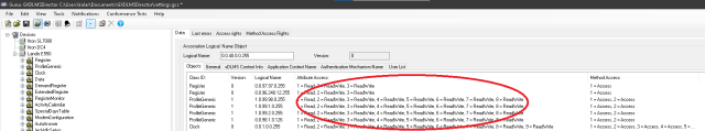

What I don't understand is how Gurux DLMS Director determine list of attributes and their access rights (see attached screenshot) ? How can I populate list of attributes and methods in my software ? Of course there is option to populate it based on class_id which is defined in standard but this method cannot be used with manufacturer-specific objects. Also this approach cannot reliably determine if some attribute supports read-write access or only read access (without actually trying to change its value).
Attaching logs from Gurux DLMS Director:
