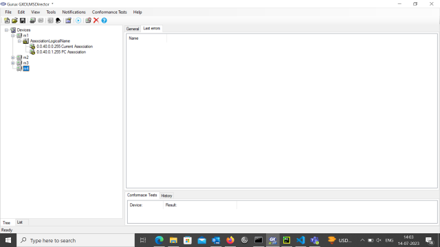

Can you please provide with xml file containing real meter readings ,because I was unable to find any data in the template which was given in crystal.xml (Github project)

Hi, The simulator is using…
The simulator is using crystal.xml and you don't need it in GXDLMSDirector. Select Indian Standard as a manufacturer and set the correct password and you can connect for the meter.
