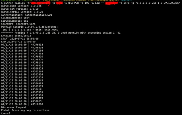

I am facing 2 problems using readRowsByRange in the DLMS python library.
Being a newbie in that kind of stuff, I reused Client.Example and modified it to reach what I wanted. I need to retrieve historical data from one or several selected registers.
1. First problem is when I make my call to readRowsByRange (I have not modified it in any way), I am getting the data I want, only each value is labeled with a datetime corresponding to the start value (defined in GXDLMSReader.py).
See linked image (I modified the g flag so that it sorts what corresponds to a profileGenerics or to an object and get the different historical data for each register).
Note that the correct time values are returned when using GXDLMSDirector.

I forgot to mention: the device manufacturer of the meters I am communicating with is Iskraemeco

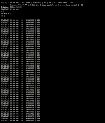

Erratum: the measurements are all labelled with the same datetime corresponding to the time of the first measure, not the starting time (set by me).
It also seems I am not facing the same issue with every profileGeneric objects (see screenshot below).

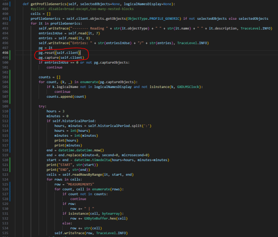

CyrilGeo
3 years 2 months ago
Hi Kurumi, Thank you for…
Hi Kurumi,
Thank you for your explanations!
I tried the reset and capture methods from GXDLMSProfileGeneric class (I also tried only using capture method) but it seems not to change anything. Here is the implementation of my modified method getProfileGenerics (see screenshot).
Am I missing a point?

Hi, Please, add plain text…
Please, add plain text. Pictures are hard to read.
You need to send generated bytes for the meter. Now you have only generated them.
Something like this:
data = pg.reset(self.client)
self.readDataBlock(data, reply)
CyrilGeo
3 years 1 month ago
Hi Mikko, Thank you for your…
Thank you for your tip ! I think I am doing it right now (using capture() instead of reset() because reset logically seems to clear my history which is not what I want):
data = pg.capture(self.client)
reply = GXReplyData()
However, I am getting the following error:
Access Error : Device reports a unavailable object.
when executing readDataBlock (raised in readDLMSPacket2)
It would let me think that the profile generic object is somehow not recognized which is odd since reset on this same object seems to work as expected.
Below are the current implementation of the getProfileGenerics method and the Verbose output for it.
Again, thank you very much for your investment!
Best regards,
Cyril

Unfortunately I don't think that the problem for pg.capture is of this kind since I printed the logical name and type of my profile generics object just before calling pg.capture and here is what I got:
TYPE: ObjectType.PROFILE_GENERIC
Moreover, here is what I can read from my association view output file:
<GXDLMSProfileGeneric>
<LN>1.0.98.2.0.255</LN>
<Version>1</Version>
<Description>Ch. 0 Data of billing period Scheme 2 #1 Unspecified number of most recent billing periods</Description>
</GXDLMSProfileGeneric>
This lets me think that the problem is deeper, particularly when pg.reset is working perfectly fine on this same profile generics object.
Maybe the data returned by pg.capture is not correct and ReadDataBlocks is failing for this reason?
Note that my GXDLMSSecureClient has useLogicalNameReferencing=True. Should I set another parameter in that client so that the "method" function (called by pg.capture) is returning correct data?
After testing on GXDLMSDirector, I noticed that the same error occurs when clicking "Capture" in profile generics data.
Here is a reminder of what I am doing in my getProfileGenerics method:
Thank you for your time! Let me know if you need any other information.
Cyril
