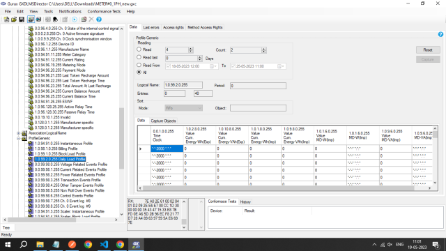

Is there any way to delete the old data in the DLMS meter? It is showing some junk values
3 years ago
Hi, You can't remove single…
You can't remove single rows but you can clear the buffer of the meter if you select "Reset" button.
It will clear all data from the profile generic buffer!
