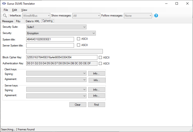

Pasting the received data into GXDLMSDirector / Tools and translating however, it cannot not decrypt the encrypted message part - see pasted code below.
The xml output created by the code on the raspberry Pi using the python lib detected ciphered content (<GeneralGloCiphering>). But could also not decrypt it despite providing the translator with the cipher key.
The cipher key is correct: got it via the web portal of my provider and i double checked, that it is the key for the corresponding meter (serial no).
My provider specified security suite 1 and AES128-CBC - however, reading the topics here i learned that the AES mode used by the meter is not CBC but CGM!!
However, i assume if i specify suite 1 in GXDLMSDirector it will decrypt using GCM?
Here now the Director translation / raspberry dump / Director setting screenhot:
Thak you for any hints on that - im currently stuck

miguelito
3 years 1 month ago
Appended a pic with the…
Appended a pic with the Director / Tools / Translator cipher setting
3 years 1 month ago

I am sorry, but I was just too stupid to work with Director properly:
I somehow expected DLMS Translator also to do the encryption directly in the Messages output window .
But of course just one by one...:
Copying the payload of the 2 telegrams (from the messages output window) to the PDU tab did the trick. PDU-> XML also does the decryption. Now I know it works and can focus on coding again.

Hi Michael, The data is…
Hi Michael,
The data is coming in multiple frames and PDU is not parse automatically as a default. Select "View" and "Complate PDU" and you can see the data as XML. You can test that with the python data.

Hi Mikko, > Select "View"…
Yes, thank you, that did the trick for the Messages Output window, now I can see the deciphered xml there as well.
