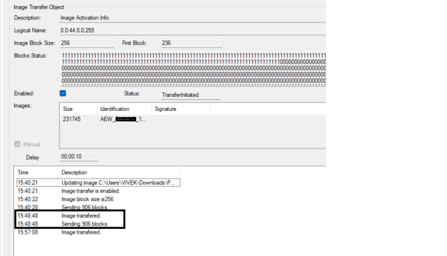

Image transfer via TCP port using image resume service in this case image transfer again restart whereas resume transfer is completed.
3 years 6 months ago
Hi, You have select Manual…
You have select Manual mode. You need to verify and activate the image pressing "Verify" and "Active" buttons.
If you press "Update" button it will send all the blocks again to the meter.
