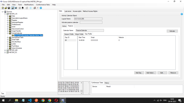

Its returning null value I…
I read through GXDLMSDirector only time is showing script and selector is missing.With which script and selector I should update here?
3 years 6 months ago
Hi, You have added a script…
You have added a script to the day profile that doesn't exists. You need to select the script that you want to execute here. You get the list of all scripts when you add a new action.
