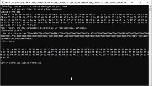

We tried with push listener & we got the octect string as response (PFA the attached
image)
What kind of data the octet string represents?
Total Bytes: 122 bytes (sample as attached image)
Octect string:
"31641AE0E50091000000452A3C0000000000000000000003641A996000000000000000000000641947E0000000000000000000006417F660000000000000000000000163FEE9E0000001010000000000000000000000000000000000000000000000000C07E70214FF0D0110FF800000008002000000000009FF"

Hi, Please, don't add images…
Please, don't add images. Plain text is better.
You have one structure that includes an octet string. What is expected data? Should this be a compact data structure?

Hi, The first byte (0x31 =…
The first byte (0x31 = 49) is Compact Frame id #49. C# stack can't parse pre-defined UNI-TS 11291-11 compact messages. Everything else is there, but you need to get UNI-TS 11291-11 standard and check the structure of "Trama compatta" for CF49 and manually parse received data from the bytes.
Our clients are receiving "Trama compatta" messages from CF1 to CF21 so I can't help you with CF49.
We have UNI-TS 11291-11-2 and that doesn't define CF49.
