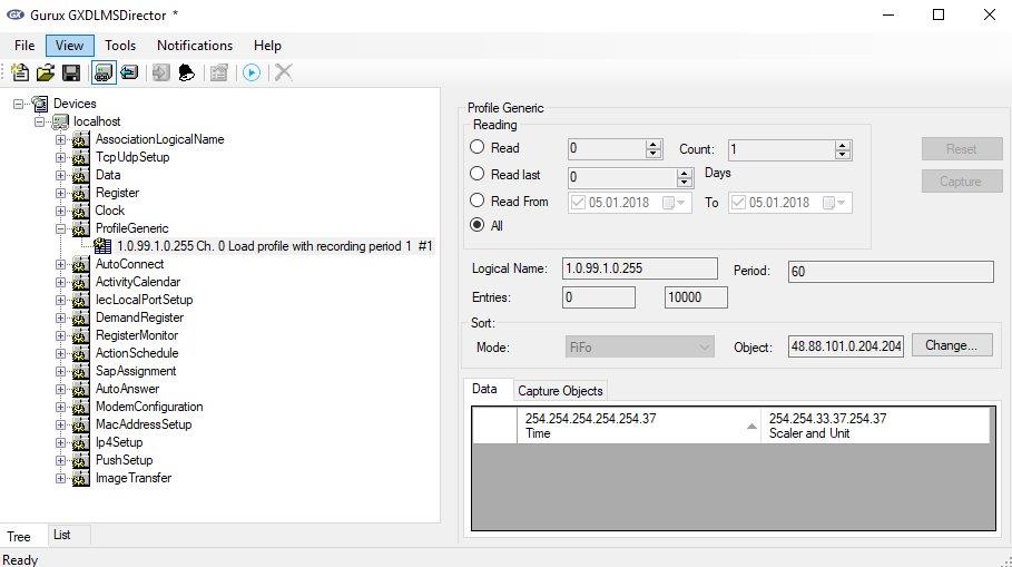

Im reading profilegeneric in example cpp app and dont know how to show all/selected values. I see, that profile contains 10000 values in two registers, but im not able to view them. What I see is attached on picture.
Are the register values right? Or there must be codes for registers available in the meter (demo app)?

So meter is example cpp code? Check OBIS codes of captured objects. This time column is usually clock object. You can populate values on PreRead. Also you have select Scaler and Unit to captured object.
What data you are sending?

Yes, sensor in gurux.dlms.server.example.cpp without any modificiations.
OBIS codes of objects in profile generic are 254.254.254.254.254.37 (Time) and 254.254.33.37.254.37 (Scaler and Unit), is this okay if theese object doesnt exist in the sensor data?
I dont understand your question about the data, what i sending. I expect that meter send wanted data to me. Or i have to generate/add some data to example app and make readout after that?

We have updated example. Get the latest version.
