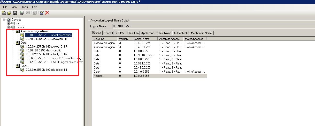

on Tool-->Read we are only getting the following values
AssociationLogicalname
0.0.40.0.0.255 Ch 0 current association
0.0.40.0.1.255 Ch 0association #1
Data
1.0.0.0.6.255 Ch. 0 Electricity ID #7
1.0.96.160.0.255 Man. specific
1.0.0.0.1.255 Ch. 0 Electricity ID #2
0.0.96.1.0.255 Ch. 0 Device ID 1, manufacturing number
0.0.42.0.0.255 Ch. 0 COSEM Logical device name
clock
0.0.1.0.0.255 ch 0 clock object #1
