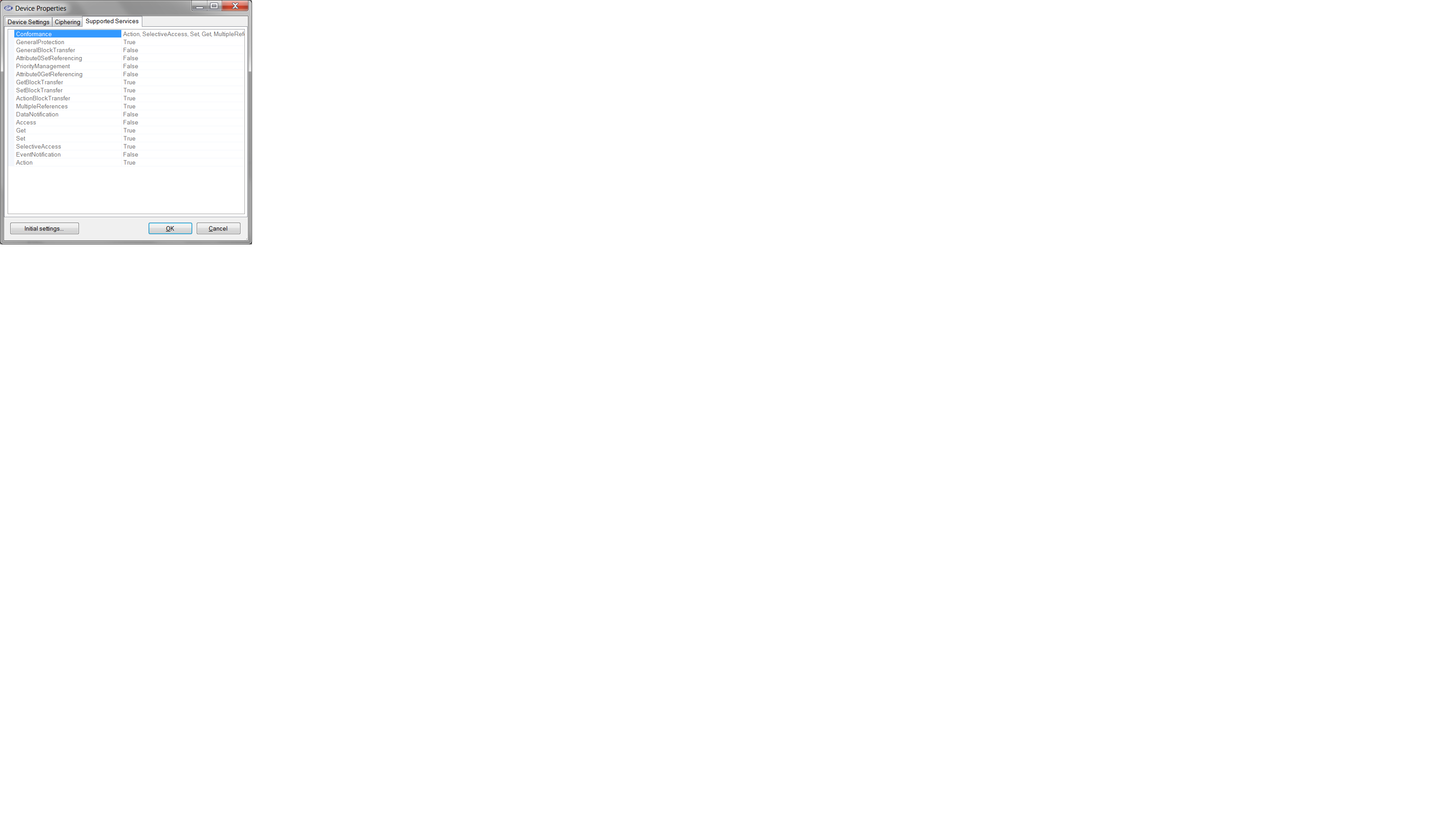

how can i , please, modify some service in conformance supported service, it seems that this can not be writable :

We have released new version from GXDLMSDirector.
Re-start GXDLMSDirector and it will say that there is new version available.
Update that and you can see conformanse settings.
You can modify them. When connected to the meter you can see what conformance settings meter can support on same page.
