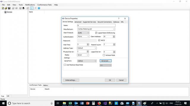

I already did it in this way
I already did it in this way, but the issue is still.
I use optical cable ,
The meter can be connected using another software, this means that the cable is good and no issue in connection settings, but when i try to connect meter using your software, the connection fail.
Also, plz find my below screen shot.
Thanks in advance,
Ahmed
7 years 4 months ago
Holley Meter DTSD545
Can you get a trace from the bytes sent by other software? Client or server address must be different.
Have you checked serial port settings (baudrate, etc)?
