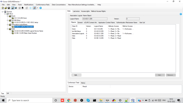

We gave it a try but I was only able to read logical name and serial number. Looks like we are not able to read the other parameters because the password is not there for a low security authentication!
No other parameters we are able to read.
Can someone advice on how to read the same?
We have three phase CT operated meters and a whole current meter that we are trying to read from the DLMS Director.
