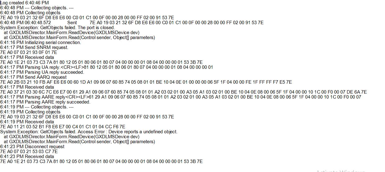

Hello, I am Hasha, From Mongolia. First of all, Thanks for this great project. I have to read Holley DTSD545 data via DLMS and I have faced problem. Please help me for this. Also, I attached error pic and log pic.

Okay, I am sending to you log file and initialize settings pic. Also Holley send to me their OBIS.

11:00:01 AM --- Collecting objects. ---
11:00:01 AM Collecting objects
7E A0 19 03 21 32 6F D8 E6 E6 00 C0 01 C1 00 0F 00 00 28 00 00 FF 02 00 91 53 7E
11:00:01 AM 11:00:01.818 Sent 7E A0 19 03 21 32 6F D8 E6 E6 00 C0 01 C1 00 0F 00 00 28 00 00 FF 02 00 91 53 7E
11:00:01 AM 11:00:01.879 Received 7E A0 11 21 03 52 B1 F8 E6 E7 00 C4 01 C1 01 04 CC F6 7E
11:00:01 AM Received data
System.Exception: GetObjects failed. Access Error : Device reports a undefined object.
at GXDLMSDirector.MainForm.ReadDevice(GXDLMSDevice dev)
at GXDLMSDirector.MainForm.Read(Control sender, Object[] parameters)
11:00:02 AM Disconnect request
