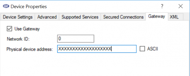

We plan to connect to a E450 from Landis&Gyr via a DC250 concentrator using the DLMSDirector.
Do we need to set the Serial number in the Physical device address field from Gateway menu ? (see attached picture).
