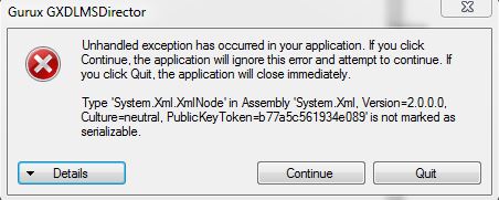

I am trying to install GURUX GXDLMS Director version 7.0.40.1. After installing it whenever i go for tools/manufacturers it gives me the exception . The screenshot of the exception is attached .
10 years 6 months ago
Problem in installing gurux dlms client
You should download and update Microsoft .NET Framework 3.5 Service pack 1.
That should fix this issue.
