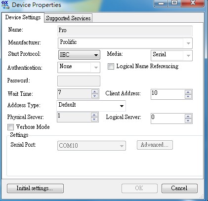

when I return AARE to client, clinet sent "disconnect request" to Server.
why, how do I fix this problem?
my log
06:47:57 Parsing AARE reply<CR><LF>61 29 A1 09 06 07 60 85 74 05 08 01 01 A2 03 02 01 00 A3 05 A1 03 02 01 00 BE 10 04 0E 08 00 06 5F 1F 04 00 00 10 10 00 64 00 07
06:47:58 Disconnect request
7E A0 07 03 21 53 03 C7 7E

Your reply is correct and there is nothing wrong with it.
Can you get any more info from trace?
