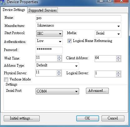

I use director to verify Mode E.
my device properties as att. file,
(start protocal : IEC / name : pro / manufacturer : iskraemeco / serial mode )
when i press connect, director will be sent /?! by uart_tx.
my meter sent "/pro2isk000654321" to director, but director will be stop and show " B0 " and " Failed to receive reply device "
I dont know some thing wrong. can i read more detial error message?

Iskraemeco
Three first charachters are manufacturer Flag name:
http://dlms.com/organization/flagmanufacturesids/index.html
Your reply seems correct. Is there a DLMS label on the cover of the meter?
Are you using serial port or optical strobe (eye)?
dafeng0908
10 years 4 months ago
In reply to Iskraemeco by Kurumi
many thanks,
many thanks,
i find my bug..
my manu. name is wrong~
