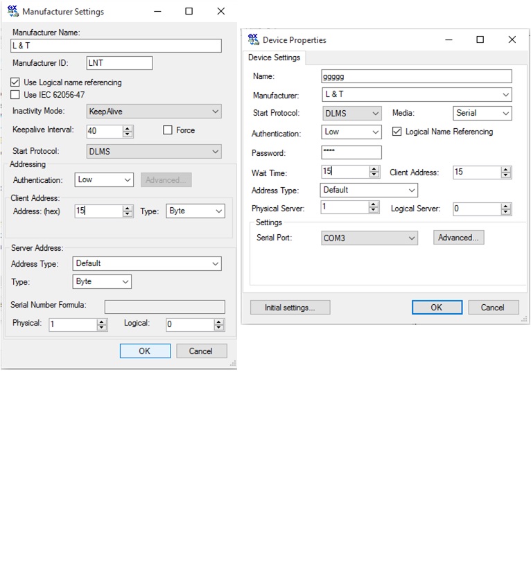

We are not able to connect to L & T meter with 0x15 client address and Low authentication password.
First we have connect with public client 0x10 and able to read mandatory objects
0.0.40.0.1.255 Public client association
0.0.41.0.0.255 SAP Assignment
0.0.42.0.0.255 Logical Device
0.0.1.0.0.255 Clock
0.0.22.0.0.255 HDLC Setup
However when we use client address 0x15 with Low authentication and password it is not able to connect.
Password given is lnt1
Please let me know how to proceed.
