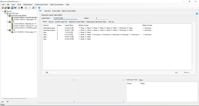

Please suggest, we need to read all capable parameters ( Particularly Eneregy Parameter) from the All Energy meter( Aper150-Secure meter).
At present, We received only general meter Parameters - received at Client Id 16.

Hi, Your meter doesn't allow…
Your meter doesn't allow you to read all the objects with public authentication. You need to use Low or High authentication to access all the objects.
Change the client address and authentication level and you can see missing objects. You should get the client address from the meter documentation.
